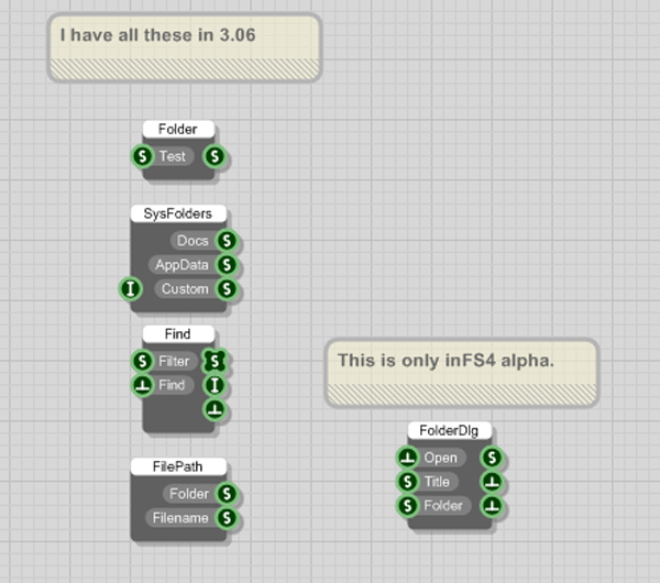

Gratulation on your system. Sounds like a good approach. However, the quote above is not true. You can do the same thing in 3.0.6 as well.Spogg wrote:When you switch to Expansions you load a folder (not wavs). This is only possible in the FS4 alpha.

tulamide wrote:... the quote above is not true. You can do the same thing in 3.0.6 as well.Spogg wrote:When you switch to Expansions you load a folder (not wavs). This is only possible in the FS4 alpha.
Oh!
Then my toolbox is broken, because I looked for the load folder prim and it wasn't there! Oh dear...
Re: Help Johan with Rompler expansion system
you can actually do that since SM...
If you don't specify what file to open with the find file prim... it loads the entire folder content, according to the file type you selected...
tektoog - Posts: 141
tulamide wrote:Gratulation on your system. Sounds like a good approach. However, the quote above is not true. You can do the same thing in 3.0.6 as well.Spogg wrote:When you switch to Expansions you load a folder (not wavs). This is only possible in the FS4 alpha.
Well my toolbox was broken, so I fixed it from a backup.
However I still couldn’t find the Folder dialog prim. I also looked in SynthMaker and not there either.
So I’m still of the opinion that it’s new in FS4 (and wait to be shot down!).
The attached schematic is made in FS4 alpha and contains the prims above.
Folder prims FS3 vs FS4 .fsm- FS4 ALPHA!!!
- (1.1 KiB) Downloaded 1016 times
Spogg wrote:tulamide wrote:Gratulation on your system. Sounds like a good approach. However, the quote above is not true. You can do the same thing in 3.0.6 as well.Spogg wrote:When you switch to Expansions you load a folder (not wavs). This is only possible in the FS4 alpha.
Oh, I see. Your quote was misleading then. "Doing it in green (without Ruby) is only possible in the alpha", is what I would agree to immediately. It is no big deal to load all files from a folder in Ruby. It is also no big deal to select a folder. You just don't have the system-provided folder dialog, but your own solution.
