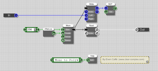

Question re the mono to poly prim.
I presume that it takes the signal on blue channel 0 and applies it to every poly channel. Correct?
I wondered if there's a way of directing mono4 blue channels individually?
This is not exactly what I have in mind but describes the idea anyway ... say I have 4 free-phase LFOs - 'LFO1, 2, 3 & 4' - on blue chans 0, 1, 2, & 3. Can they be applied to a poly section such that notes 1, 5, 9 etc would use LFO 1; notes 2, 6, 10 etc would use LFO 2; notes 3, 7, 11 etc. would use LFO 3; and notes 4, 8, 12 etc. would use LFO 4.
Or is this delving into forbidden polyphony-handling world ...
H

You can do similar things with the alpha version, that has some new mono to poly primitives

Thanks Adam & Michael,
Using two variations on the 'poly2mono4 combiner' module I've managed to do exactly what I proposed above with 4x independant LFOs, (which I emphasise is not my ultimate aim ..) but I couldn't get it to work in 3.0.6 .. sorry FS3 fans!
Obviously generating multi-LFOs is not very original, but I don't recall having seen a method of injecting any 4 blue 'objects' into chans 0, 1, 2 & 3 of a poly stream.
So I'll post the demo in Slack later.
H

Postby k brown » Tue Jul 07, 2020 12:14 am
Mono to Poly's been around since SM days.
Re: Mono to Poly question
Postby nix » Tue Jul 07, 2020 12:21 am
yeah, that one writes and reads the stream,
in an early hack
Alpha made that a prim iirc
this implementation is more sophisticated it seems,
involving tagging the streams

Postby HughBanton » Tue Jul 07, 2020 9:22 am
Adam pointed out (in Slack) that my LFOs, although having blue connectors, still behave like regular stream components, and reset to phase-zero when keyed.
I've posted a revision over there with mono2poly prims inserted, which seems to fix it. For those with an electronic background, they behave a bit like 'blue diodes', holding back any poly-stream influence from beyond!
Does that make the 'trigger blocker' a green diode? Beginning to sound like material for one of @Spogg's Flowstone dream sequences :lol: .... . .
H
