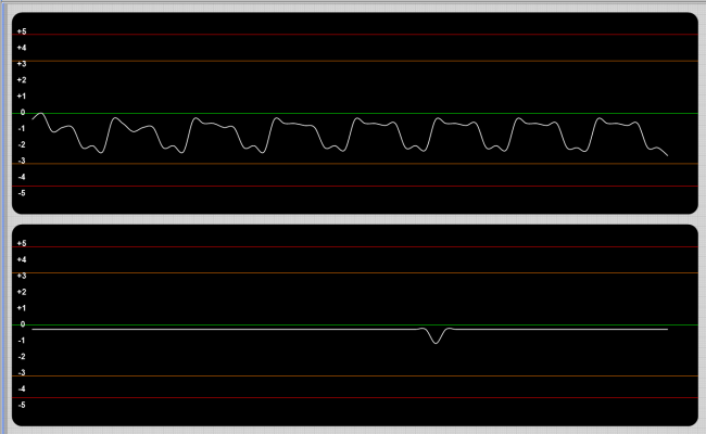

If I make an array in a ruby component
and I initialisize the elements with a value of 52 and by every call of this ruby component I change 1 element.
so after 64 calls I have 64 avaraged values? No..... every time the other 63 element are again 52????
How can I get it not everytime initialisized? I have read 3 ruby books but I can find it how a one time initialising works
I try to use stage(0) but that can not work because Ruby needs to see continue that c is an array.
The green line is a value of 50 the upper white line are the actual values and the white line in the second screen
need to be 64 avaraged values of the upper screen.
c = Array.new(64,52) # 64 elements with a value 52

You need to use instance variables. You initialize an instance variable by putting "@" at the beginning of a name (for example @variable ). Best place to do so is in the "init" method, which is called first, when the schematic is loaded.
here's an example code (note: it will not work in the form down there - you have to specify the "someIndex" and "someValue" depending on your needs):
variables wothout the "@" are local variables and they are local to each function call (they are deleted after function returns).
def init
@a=Array.new(64,52) #initializes instance variable @a, which is array of 64 integers with initial value 52
def event i,v
@a[someIndex]=someValue
output @a

the average for array
@array = [5,6,7,8]
array_sum = @array.inject(:+).to_f
array_mean = array_sum / @array.size
watch 'mean', array_mean # => 6.5
watch 'sum', array_sum # => 26
