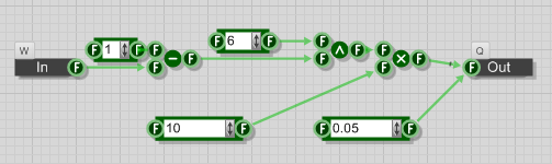

If you navigate to the "Convert" modules,
Parametric EQ/GUI/Controls/Convert
you'll see the following conversion from W (width) to Q.
The formula is
Q = 0.05 + 10*(1 - W)^6
So when you drag W from 0 to 1 (in whatever units), Q decreases from 1.05 to 0.05. All good so far. However, if you drag further, since the power 6 is an even number, Q starts to increase again.

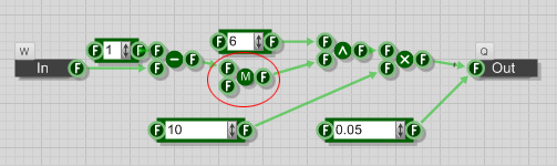

What I did is place a Max module after (1 - W) with one input not connected (same as if connected to zero) :
