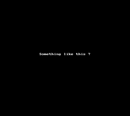

You mean the wet/dry knob ?

Re: Single knob/button Equaliser
Like this ?
lalalandsynth - Posts: 600
Like this ?
I would share the schematic but i am working on another version of FS, hope this helps.

Yes, Martin helped me out with that in a similar way.
The vst is ready now, tested and works wonders. I'll link a demonstration video soon!
