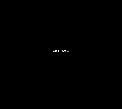

So after chasing this GUI cpu bug/problem that haunts me and not solving it, I started a new project , its about 1% cpu.Then I start loading PNg´s , adding nothing to audio processing and boom its at 14 % cpu , which is always my exact CPU problem with everything I do and I can never really bring it down.
No running meters or moving graphics, only Png backgrounds, and Strips.
I always load png´s as backgrounds , knobs etc , I wonder if the cpu/Gui problem is simply caused by loading the GUI elements and not triggers and such ?
lalalandsynth
Posts: 600
Re: Possible GUI /Png Bug.
Postby lalalandsynth » Sat Oct 06, 2018 1:27 pm
So, the project reached 14% cpu, I shut it down, open the one without png GUI.
Its then about 3% and occasionally jumps to 5%.
Open the same project with the GUI and its anywhere from 7% to 12%.
Why is this ?
Like I said , most of my projects sit at 14-16% and I cannot figure out why .
Png issue.gif (693.98 KiB) Viewed 15194 times

Postby martinvicanek » Sat Oct 06, 2018 1:55 pm
Post an example so we can see what's going on. ;)
