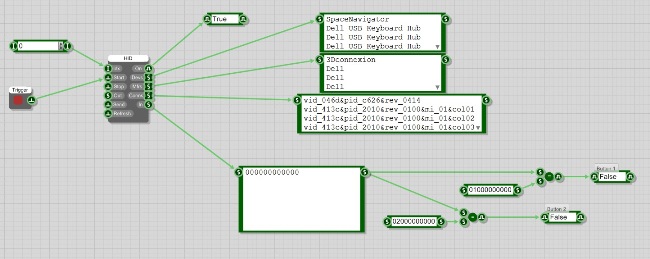

Works fine here, but I don't know what to do with the data. Too bad the forum doesn't allow higher resolution images.
- HID.jpg (52.49 KiB) Viewed 16362 times

Re: HID sample
That's cool you got it working Asbjorn.
I've tried with a PS3 controller, it connects but sends no hex.
I know Jay has the same problem-
any chance of a fix Support?
I would love to have the PS3 controller up.
I guess you can parse the data any way you want Asbjorn.
There is a hex converter in the toolbox, maybe it helps?
