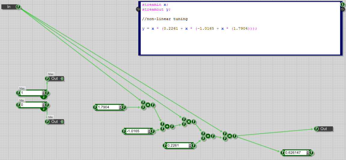

I was hoping for Ruby to be a replacement for so called "green code". As for real-time DSP, we already have code component and asm. However, all the interface (which can get really fancy in synths) needs to be made with endless networks of green components.
Real-life example: non-linear tuning for my synth needs to be done like that:
Nonlinear tuning.png (62.66 KiB) Viewed 34639 times
This is confusing at least, as you see, writting it in code is so much easier. However, it causes excessive CPU usage.
Now, imagine tunable filter of arbitrary order done in such way. Nightmare. WIth dynamic arrays and mathematical expressions things would become easier.
What does Ruby offer here and what kind of performance cna we expect with controls sampled every 25ms?
