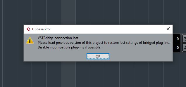

I had this error from FS made vst fx plugin today.
Does anyone know why it does that?

Look s More like a cubase problem.... Did other versions of the VST work? Did you try Them with the 32 bit Version.......

Nubeat7 wrote:Look s More like a cubase problem.... Did other versions of the VST work? Did you try Them with the 32 bit Version.......
Other 32 bit plugins work (they are not FS made). I have 64 bit version Cubase :I
Everytime I get this errors (because of FS's only 32 bit support); I really regret buying FS

i meant if other versions of your own vsts did work with it, there must be something in your program what cubase doesn't like, i had this with repeat x, one of my plugins, i had to change a huge part of the plugin to make it work, at the end i saw that it was just really bad programmed from my side and with the new much smarter solution it worked well.....
i really recommend to test your plugins in the daw during the whole growing process and save every working version, this is really important if you break something working or when you include something which makes it crash, other wise it is nearly impossible to find the part which breaks it....
so you can start with a simple volume vst and try if it works with your daws and then start to enlarge them till it makes troubles, only then somebody from the forum or the devs can help.... with "my plugin crashes, its the fault of FS" it is difficult to help you

If you'd like to upload your plugin and schematic, that causes the problem, we can test and offer better advice. I can test in Reaper 32 bit and 64 bit on Windows 7 for example.
If you don't wish to share your schematic we can at least test the plugin which should help to prove if it's Cubase on your system or not.
Over to you...

you also should test them with the 32 bit versions of the daws so you can see if its because of the bridge or not..

Thank you for your help.
https://www.dropbox.com/s/1didbxpw0bohroa/DW.rar?dl=0
Best regards...

the whole plugin is broken, did you upload the right version? there are many dead ends and inputs are not connected .... its always good to clean up and tighten the schematic before sharing so it is easier for others to see what happens...

Nubeat7 wrote:the whole plugin is broken, did you upload the right version? there are many dead ends and inputs are not connected .... its always good to clean up and tighten the schematic before sharing so it is easier for others to see what happens...
Other modules are not finished yet, that's why other pages are not showing when navigation buttons are clicked (except FX button). Actually main problem is in FX Rack module, I think. Because when I modified and finished this module, it started to make errors.

with all the open ends and inputs its no wonder that it crashes, there is no signalflow from input to output, the input gets just lost in a dead end after the input amp, this would also fit with your crash info that vstbridge lost connection....
