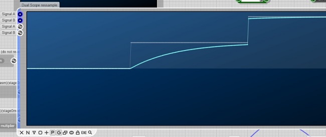

After testing thru my presets I started noticing the stage0 mod has some strange issue which makes it unusable as is...
The first note (poly stream) fired off makes the dezipper give wrong value, but "holding/sustaining that note/polystream" makes all the subsequent polystreams played give the correct value from the de-zipper (or atleast a more correct value).
The original MV asm doesn't seem to suffer from this strange behaviour so it must be the stage part that causes some wierd interaction between the poly streams?
The problem might only manifest itself in my schematic
Edit #2:
Ahh ok
The stage0 does indeed transition on first poly stream but then almost hits (depending on time between) target value on next subsequent poly streams
Hmm... I'm a little bit hesitant in using the spmod version also, since the multiplier is not bound to sample-rate or is it? I have to be certain that the multiplication will result in the same slope at all sample rates.
But it looks like the "stage0 spmod" version doesn't have the same problem as the "stage0 only" version... That is weird
I'm going to try and use some of the spmod versions in my plugin and test...
dezip MV stage0mod test.fsm- (46.58 KiB) Downloaded 543 times

Oups sorry, i did'nt think about this.. The stage 0 will reset with new note..
For the multiply it's ok for the sample rate, that are take into account in the green process.

For the spmod that do not reset that's really strange. (just seen your schematic)
But if you play more notes it begin to also reset like the stage 0.
Erasing the 3 first line after the float would be better.
