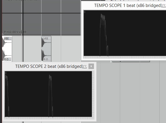

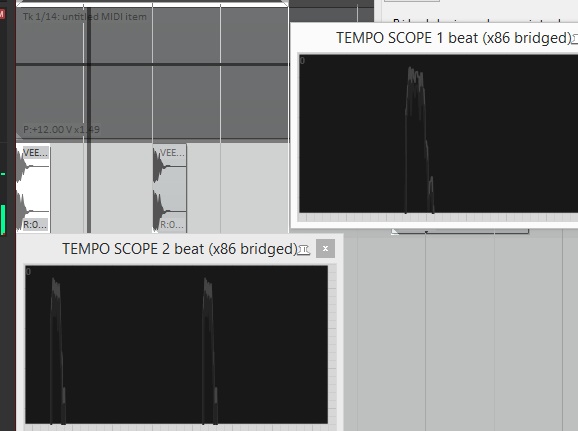

This is all kinds of weird. Did this work perfectly for you ?
Maybe I am just misunderstanding this and it should not start at the beginning of the scope window ?
That would explain a lot?
I hit play and it shows up here .
weird 1.jpg (38.93 KiB) Viewed 13388 times
I hit play again and it shows up here.
Weird 2.jpg (36.26 KiB) Viewed 13388 times

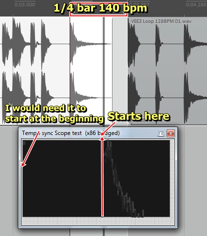

The "problem" for me is getting it to start at the beginning of the scope window.
It is not clear to me if it should do that and just not working or if its designed like this ?
Sync scope.jpg (57.86 KiB) Viewed 13371 times
