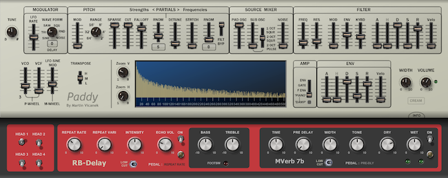

PadOsc722 looks to have a stereo structure internally, but all the presets are mono (?); and I don't hear the Width control having any effect.
Also, the noise module inside the padOsc itself has a note that it's only to be used with 3.0.8; can that be replaced with one that doesn't have that restriction?
Here's what this is looking like - lots of functions added; based loosely on the SH-101. Martin's presets are retained - added a few of my own; and a bunch by Manfred Plummer.
https://ln.sync.com/dl/62c9b9f70/bbjdaw ... 7111110004

Hey Kevin, that's a very cool looking GUI!
Damned, another bug. Will fix that over the weekend.
It should be allright as long as you don't edit the ASM code in FS 3.0.6.
k brown wrote:PadOsc722 looks to have a stereo structure internally, but all the presets are mono (?); and I don't hear the Width control having any effect.
also, the noise module inside the padOsc itself has a note that it's only to be used with 3.0.8; can that be replaced with one that doesn't have that restriction?
Re: Something to keep Spogg busy during self-isolation
Well, the whole thing seems to work fine in 3.0.6 with the existing noise module; so I guess just leave it alone?

Version 7.23: fixed stereo.
padOsc723.fsm- Fixed stereo
