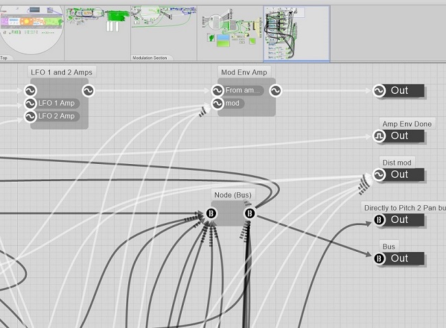

Buses buses buses...
Trying to simplify and hopefully receive some fractions of performance gains. I'm in the process of reducing packing and unpacking prims.

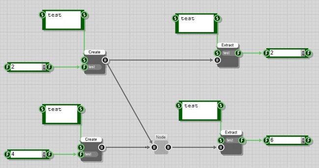

Below is a big questionmark though. I'm still unsure... Does the bus add same-named values together at junction points... or does it only add them together at unpacking? It would make zero programmatical sense that they would add encapsulated values together (at the bus level) from my logic standpoint.
I think I'll have to do a controlled test to make sure how they behave...
I know variables for example usually are assigned cryptic names inside when code is compiled... so I suspect buses themselves also are kept separate at low level.

Really?...
Well aaaa-all'righty then.
Buses really need a companion prim called "bunching" that does "only" that for using as transport up and down hierachies... I think
Maybe I'm an idiot and have missed some vital logic here. Maybe a big button in FS. Wouldn't be suprised
typical me in that case.
This behaviour doesn't rule out of course the two buses aren't still separate until unpacked
Simple analogy "bus + bus = bus[[2],[4]]"
So question is then:
Overhead cost of adding "busses as busses" vs "unpacking a lot of busses at destination (8 unpacks at each destination) and adding there". Seems just as crazy as adding buses.
I also guess there might be a difference in bus size/length. And a really interesting thing is how green float and streams coexist inside buses regarding updates and priorities... well... keeping data integrity as someone wrote.

I can confirm somewhat that I actually notice a fractional improvement after consolidating my buses, reducing the total amount of packing/unpacking. But it's hardly noticeable... I maybe gained a single voice at around 23 played notes... before my synth starts acting up on my current PC i'm testing on. It shouldn't act up at all, but I think there's some DSP filter in it that performs badly.
