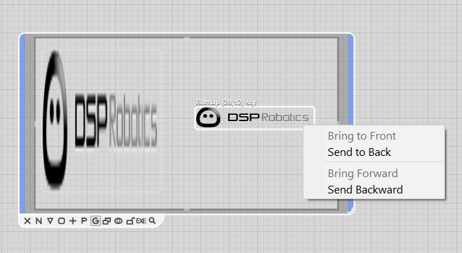

How do I put my own artwork on the background? Any inquires thank you in advance!

i add a bitmap and put my photo. In gui mode you can right click the image and send it forward or back.

Don't know exactly what you are trying to do...
But if you just want a bitmap background in a module/plugin. Place a toolbox bitmap module inside the module you wan't your background in, and make sure you send that layer (mgui) to the back.
