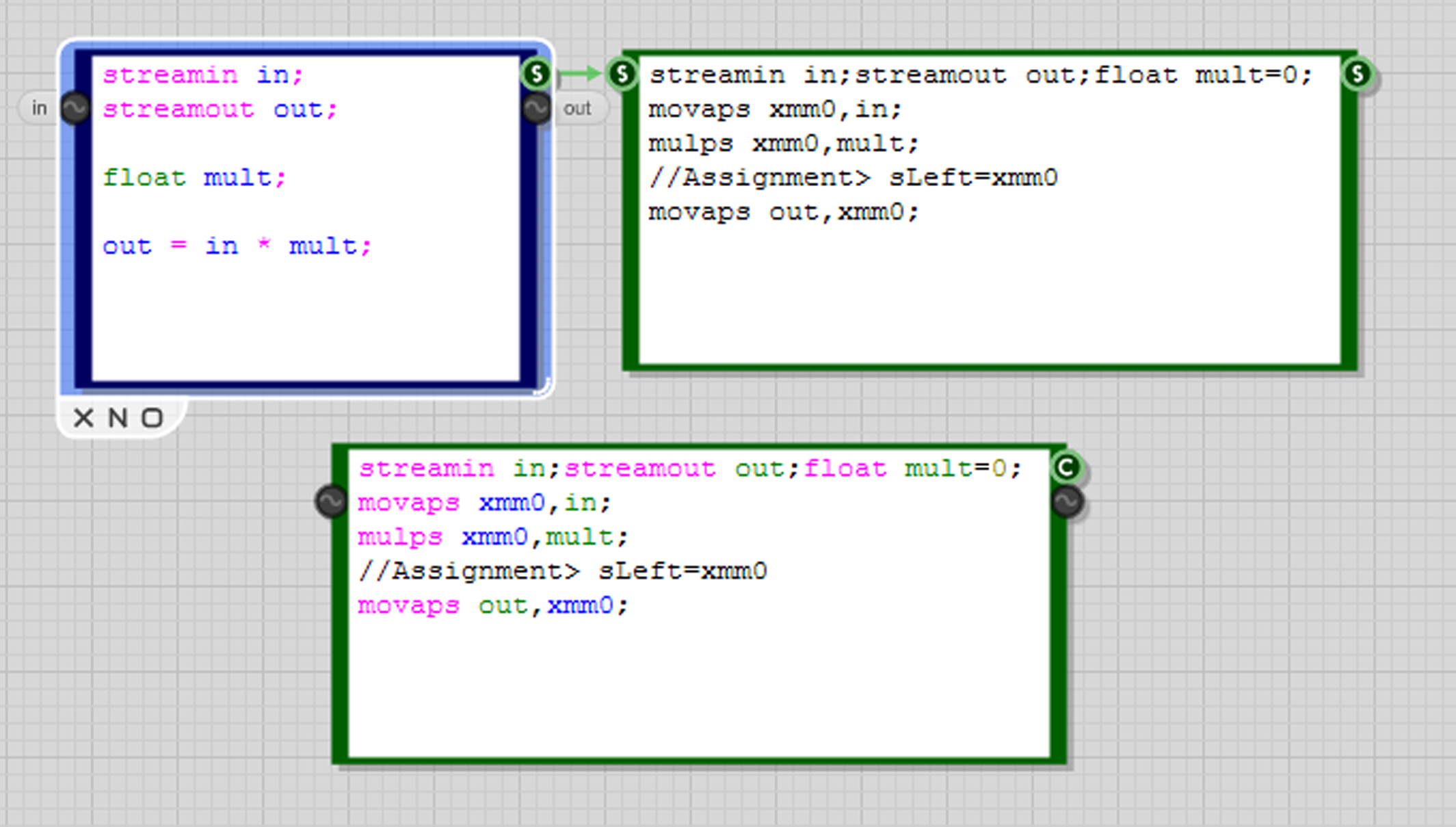

Just to add to what tulamide said, the DSP component’s code is interpreted and pre-compiled into assembler, behind the scenes so to speak.
You can see what’s been compiled if you display the S output pin in a text module.
If you copy this text into an assembler component, and you know what you’re doing (so that’s me out), you then have the possibility to optimise the assembler code generated. This means you have a good starting point and don’t have to write the whole routine natively in assembler.
