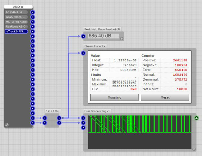

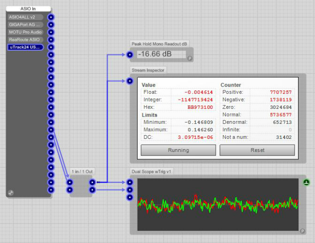

I have a Cymatic Audio uTrack 24 that works fine with Reaper using the upper 17-24 channels (all channels actually), but when I try any channel over 16 in Flowstone it fails to work or on occasion crashes Flowstone.
Working up to channels 15 and 16 (see here)
Working 15 & 16
Not Working from channels 17 to 24 (see 23 & 24 here)
Not Working 23 & 24
Any Ideas?
I have a bad feeling this is something that the developers must handle, and I think this will be of low priority :(
All drivers are updated as well as firmware. As I said the channels all work in Reaper?!? :?

It almost lookis as if the bit order is inverted or something. But I'm afraid you're right. It is about retrieving data through the driver, so that can only be handled from the developer side. I wouldn't say it has low priority, but MyCo can't do a lot if he doesn't own that hardware.
