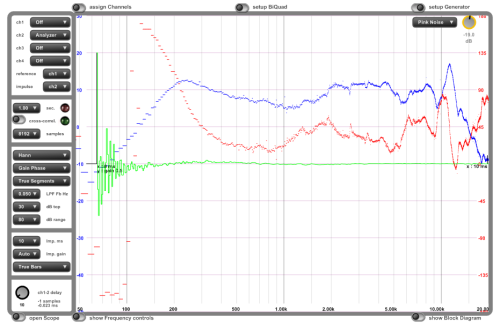

Here is a minor upgrade embedding the changes you advised, plus a new "open Scope" button at the bottom displaying the time-domain signals. Currently I'm only using such modality when sending a Dirac pulse, otherwise Flowstone crashes because of CPU overload when drawing lots of lines on screen.
The screenshot is the transfer function of a Logitech z120 speaker.
I'm perplex seeing the huge delay counting in thousands of samples between ch1 setup as "Gen" and ch2 setup as "Right-In". I can understand there is a delay because "Gen" is in digital domain, and "Right-In" is delayed by the USB link, sound card DAC, sound card ADC, and USB link again (actually, I'm using an USB audio card). However, a delay close to 10,000 samples looks insane to me.
As soon as the CPU gets loaded (say 30% CPU usage), the ch1 to ch2 delay appears to vary somewhat in a random way. This happens with the Scope being triggered by the green central trigger "do_fft". Thus, the green Triggers are far from deterministic, far from realtime. Surely the scope gets triggered by the central "do_fft" trigger, but surely also, Windows and Flowstone Green machinery are taking a certain amount of time - quite random - to execute such synchronization. When looking at the ch1-ch2 waveforms, it appears that the random delay introduced by Windows + Flowstone Green is between 50 ms and 150 ms. Is this pathologic, or is this to be considered as normal?
How would you organize the Scope trigger for a) some Blue DSP code generating a Dirac every second or so and b) the Scope being precisely triggered by such Dirac, for the Scope always grabbing Dirac at the beginning of each frame, then grabbing the 256 - 512 - 1024 ... next samples? Currently I can't do this as the Blue time doesn't correspond to the Green time. Do I need to implement the grabber in Blue (DSP code)?
