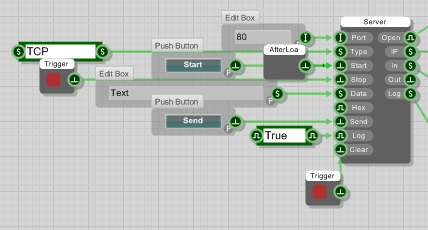

Hi, i can not make the Network Server module work when exported to .exe, it just won't start and seems not even try to connect. It do work inside FS, also Network Client works in .exe but not the server or am i missing something?

Is this test .exe working for you, DSP? TEST Server
Inside:

Morph wrote:Hi, i can not make the Network Server module work when exported to .exe, it just won't start and seems not even try to connect. It do work inside FS, also Network Client works in .exe but not the server or am i missing something?
Did you exit FlowStone before starting the executable?
Because, if not, the server inside FS is still using the selected port numbers, thus rendering those ports unusable for anyone else, including FS executables.

TomC wrote:Did you exit FlowStone before starting the executable?
Yes, had tried on other computers too, with no FS installed. No network activity.
Try my test .EXE. Is it working for you?
