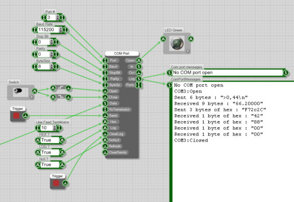

OK, I'm really having trouble with this one; though I'd expect this to be simple, I'm finding little info on it.
I'm working through the ComPort to communicate with a YostEng sensor. The returned data must come back as a 4 byte Hex code and I need to convert it to single Float.
It would appear that I would .pack the data as Hex, then .unpack as single precision float, but the two do not seem to work together...pack is part of Array, and unpack is part of String?
For example, the following returns; The ASCII return shows 66.2 degreesF, the Hex return shows 0x428800
Any direction toward a proper conversion?
Thanks!
Thanks!
- ComPorts.jpg (65.13 KiB) Viewed 17772 times

jjs wrote:i also see a 66.200000 readout in your example, what is it?
is the response of request in ASCII mode ">,0,44\n"
temperature float 66.20000
the request in HEX is F72C2C
and the response is 42 88 00 00 in byte
but after converted in float it produce 68.0
perhaps the temperature was changed between the two requests?
- Tronic
