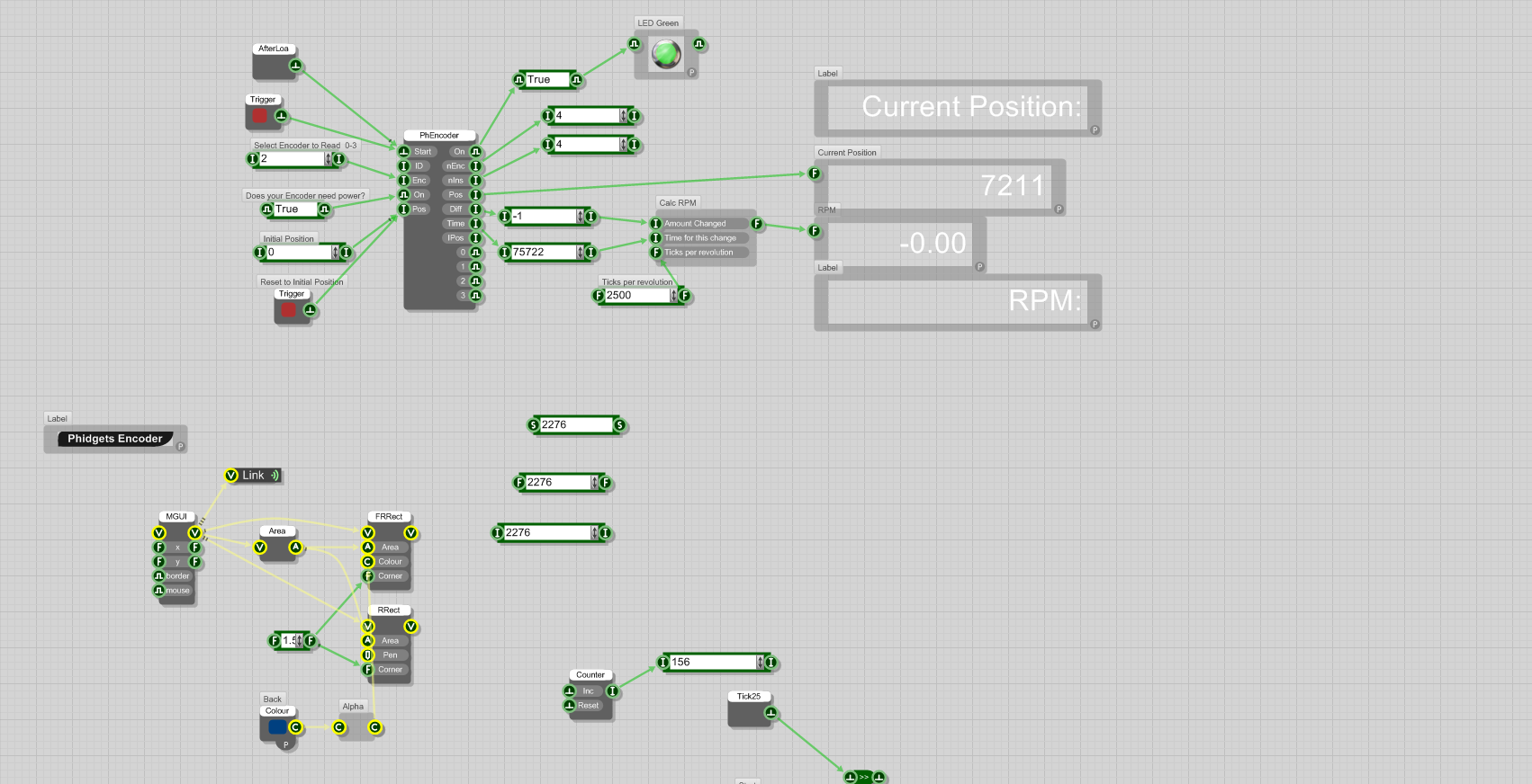

Using the FlowStone Program it was noticed that it displays inconsistent readouts on the POS "to the current position of selected encoder "
(see attached file Encoder Example 1.png = 7,211 ticks). This should read 10,000 counter position as the Phidgets and US Digital programs do.

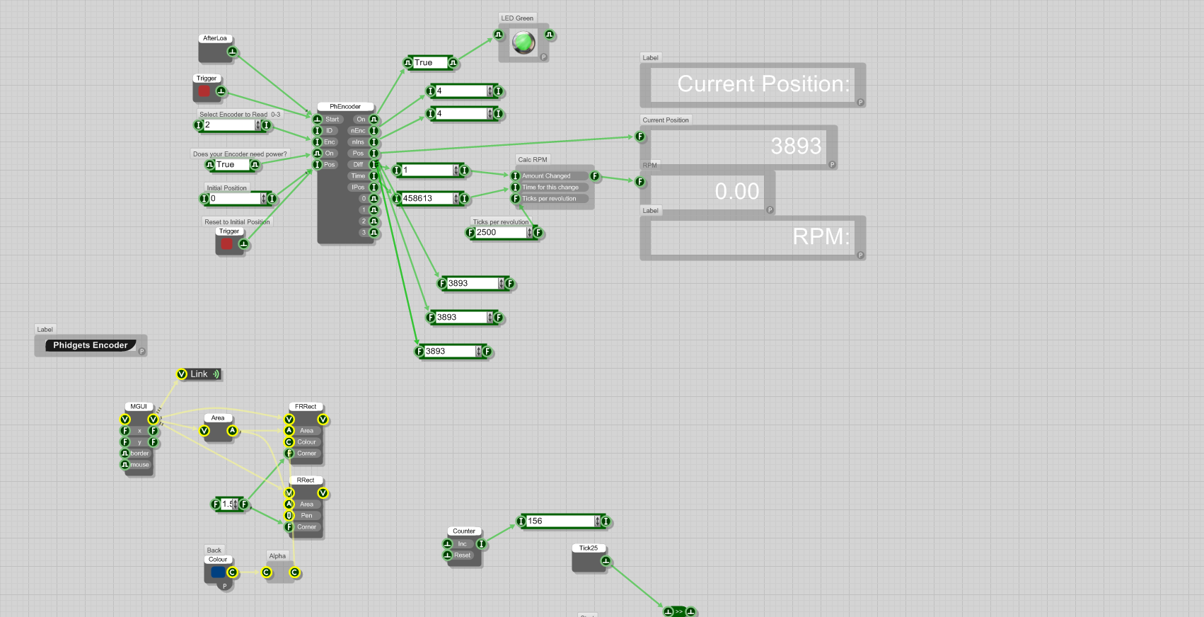

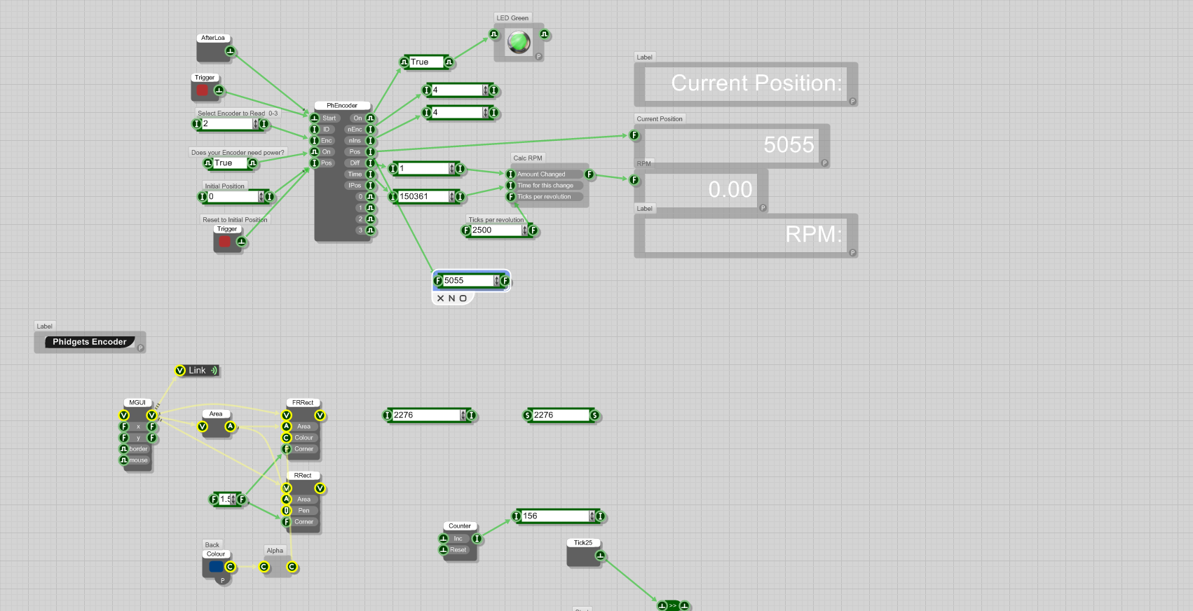

As a test, I added another Float to the output of the current position reads 5,055 (see attached file Encoder Example 2.png).
As another test, I added 2 more Floats to the output of the current position reads 3,893 (see attached file Encoder Example 3.png)
These should all read the current position as 10,000
The "Ticks per revolution" is set at 2,500. The resolution is 4X (the way I understand it, the Phidget board is a 4x). So 2,500 x 4 = 10,000 ticks/revolution. I know "ticks/revolution is redundant, so it could better be said 10,000 positions around the shaft.
