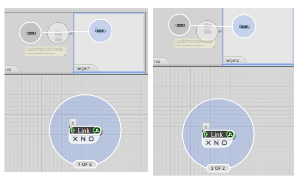

lol i didnt even know about this feature!
it gives me the correct results! on tab press it gives me "1 of 2" target 1, pressing tab again gives me "2 of 2" target 2

Jay wrote:lol i didnt even know about this feature!
Jay - click on parrent wireless, press tab (it will push you to the first receiver), and without going out of the tab search mode (still circle around) - rename the connector, confirm and press tab to go next. It should crash.

I will try that tester!
edit: yes confirmed! it does crash flowstone here aswell! it also labeled the connector as a source instead of a receiver!
