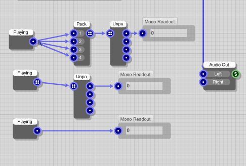

Nubeat7 wrote:'is playing' stream primitive doesn't work
It does work....
but packing the 'is playing' output , like in your fsm...there's no output...don't know why.

Yeh nubeat7...there defiantly seems to be a bug there somewhere....
In the meantime, here's a way of working around it that might help...
I'm testing in FL....
Nothing works in this pic....
Then, for some reason, just drop this into schematic..
And everything works....
give it a try with your fsm...weird...

thanks billy, i know, normally i use the green version but i need the blue one in my actual case..
i reported this to the support.
Re: 'is playing' stream primitive doesn't work
I didnt clarify this...but dont connect the green/ruby
prim...just drop it into schematic un-connected..
and still use the blue.
