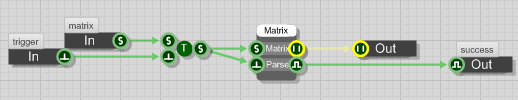

I hope that somebody is able to help me. Attached you find a replica of the reference example for the colour matrix. I would love to work with it. Problem is, I can't get the matrix to be created. Could you please check it and tell me what I did wrong?

To get a successful parse, it seems that you have to
feed the string into the trigger input as well.
here's a working color matrix module to help you sort it out.
no idea why its like this, but attaching the string to the trigger as well is
the only way I've ever got a result with it.

billv wrote: To get a successful parse, it seems that you have to
Wonderful find! I would have only found this out by accident - and who knows when this would have happened!

Of course you can make a module that has the intended behaviour of the primitive as follows:
