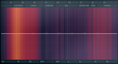

Not sure what will come of this but I'm just going to open the discussion.
Something approximately along the lines of this:
Would be wonderful to have in FS. I find it to be FAR more readable than the typical line-graph style FFT for most practical applications.
I've searched and could only dig up one example of this in the forums (including SM forums), here:
viewtopic.php?f=2&t=2446&hilit=fft
While that schematic appears functional, it devours CPU and drags down the draw rate, and only more so if you increase the window size.
Do you think something like this that's efficient enough and fairly accurate is feasible in FS? It's kind of frustrating that the line-graph style FFT is so easy to piece together in FS yet just drawing vertical lines from an FFT array is so much more complicated.

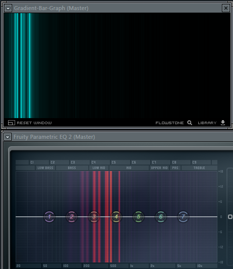

Re: Vertical Bar/Line FFT/Spectrum Display- Feasible?
Wow KG, this thing is pretty. I changed the multiplier value going into the bar graph module to 0.05 for better visibility. I did notice the scaling seems a bit odd though.
Even with the log scaling, the higher frequencies get a lot more space. Tried screwing with the math here but apparently don't know what I'm doing. Maybe it's a log base other than 10 on the PEQ2 meter?
Could alpha blending be added to the draw function easily? For example if I want it to blend between a full transparent and a solid color at max value?
One last thing: This would definitely benefit from a smoothed "release" for those transient sounds.
About time I open a book on Ruby I guess. I've been putting it off as long as possible.
Edit: Thinking the scale is log base 2, since that's what pitch is based on. How to apply log math to arrays though? I guess you'd just use Ruby for that too.

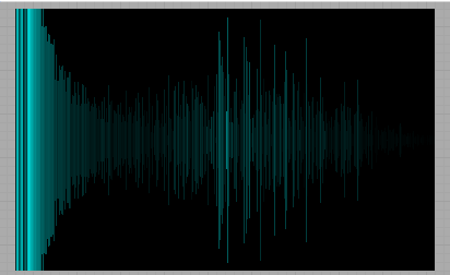

Hey look at me! I added alpha all by myself!
It's only for the background (min) color though (the "max" color is doing something else I'm not sure of with the alpha). Still useful. I mean that was the more important part. I blopped a background image in there just for demonstration.
Edit: Figured out how to set/scale the bar (max) alpha, but it's pointless here since it's just drawn on top of the background color with alpha in the first place. You can just scale the input values and it would do the same thing.
Gradient-Bar-Graph_Alpha1.fsm- (309.78 KiB) Downloaded 1224 times
