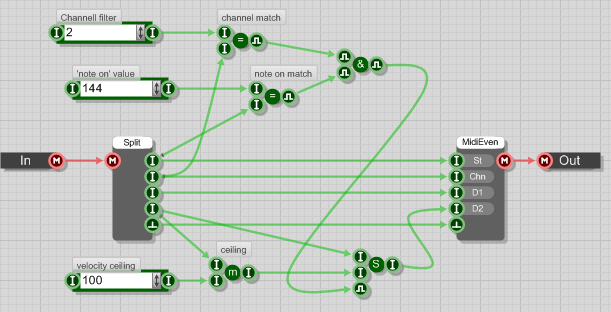

daslicht wrote:...I just get hung notes.?
If you limit the minimum value you will get hung notes if your keyboard uses note-on with velocity=0 in place of note-off messages (which many seem to do).
Do you mean physical inputs form the external device you're filtering with Flowstone - you'd have to make sure they're coming in on different MIDI channels and make the code sensitive to that.daslicht wrote:How do I just create notes when the input came from the midi in and not when something is coming in the 2 other inputs, please?
Before Ruby, Flowstone (and it predecessor SynthMaker) could do this sort of processing with a MIDI splitter and MIDI event primitives and in conjunction with math and logic components without having to code.
While these can be easy to understand when simple they can get pretty messy once you start including complex behaviour.
This module would pass everything except channel 2 note-on messages unaffected and limit velocity on channel 2 note-on messages to 100.
- capture.png (39.38 KiB) Viewed 19636 times

oddson wrote:This module would pass everything except channel 2 note-on messages unaffected and limit velocity on channel 2 note-on messages to 100.
Clean and easy-to-follow green solution. Good job!
