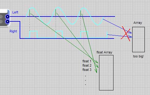

How to make this?
My English is very poor, see picture please.
- pict1.jpg (15.66 KiB) Viewed 30421 times

And see my schematic:
it is necessary to put in the Array1 ONLY samples appropriate to the "trigger1" signal.
How capture one sample on the "trigger1" signal?

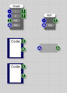

Dear developers of FlowStone!
To solve this problem, please give at least one of these components:
Thanks!
Thanks!

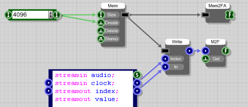

Re: How to make this?
Hi,
Sadly there is no direct interface between arrays in code and the mem primitives. It seems that the dev's intended there to be one, as in older versions of SynthMaker the syntax checker allowed "memin Variable"/"memout Variable" as declarations - but this has never been implemented.
However, you can use a setup like the one pictured below to allow code to write to any chosen index of a mem primitive...
It looks a little odd, because the 'write' connection to the mem is one of the few that goes from right to left.
Also note the added M2F - this is required, as stream components are not processed unless they have a connection to the main outputs, or are converted back to green. The M2F just acts as a 'dummy' output to enable the processing of the 'Wave Write'.
If you don't see the 'Wave Write' primitives in your toolbox - go to 'Options->Advanced', and tick the box for 'Show R&D components'. I have used these primitives many time, and they seem perfectly stable, so don't let the "under development" warning worry you too much. (NB: I am a SynthMaker user, so I am assuming that FlowStone is the same in this respect).
You can then write the code such that the index pointer to the mem is only incremented on the transitions of your clock signal. You will just need to be careful of two things...
1) The mem cannot be resized dynamically - so you have to set the size of your data 'capture' in advance.
2) The 'Wave Write' will write a value for every sample (not just when the index changes), so you will need to hold the data value at the code output until the next clock transistion to make sure that it is not written over with an invalid value.
