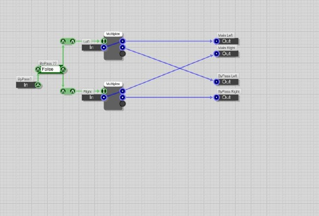

OK ... just to keep this as simple/direct, here is a basic schematic that routes audio to 2 destinations based on the status of a switch:
This design uses the MULTIPLEX Prim as the base.
I have others that use RUBY for streaming, and another using GREEN ... each of these can do the job, some better than others .... but they all crash Reaper on close
Am I missing something so basic ??

Does having OUTPUTs not connected to anything cause a problem?
Still perplex what could have happened. I'm using REAPER v:4.75 [not the very latest I know] ... Now I wonder if this is a Reaper issue ?!??
Switching OUTPUTs is just a simple BOOLEAN toggle [basically]. How bad could I have messed this up

I recreated your multiplexer schematic and tried it with Reaper 4.55 (!). No issues. For convenience I attached the version I built for use in Reaper. I suspect it has nothing to do with Flowstone or Reaper, but bidule.

just thinking ...
might the problem be due to the OPEN connection to the OUTPUT ? It's basically becomes an output with nothing there ... could these cause an issue ?
To test for something like this, could I tie in a 'default' value [like '0'] to the 2 open outputs ? How would this be done ?

Empty output = 0. But if you are not sure - put some -180dB noise to all outs. Since FS items like filters (3 months without flowstone and I'm starting to forget the names of descriptors...) don't like to process 0's, maybe the same happens on something connected after your plugin?
Option 2: instead of using multiplexers - you can create active ones using multipliers (thus - no recompiling within schematic).
