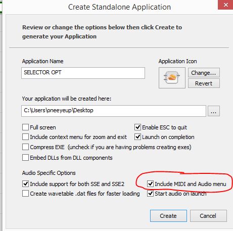

Re: Microphone inputs
Make sure you check that when exporting exe
- Capture 2.JPG (45.91 KiB) Viewed 15200 times
guyman - Posts: 207
- Joined: Fri Mar 02, 2018 8:27 pm
When you create an exe there is a dialog with a checkbox option “include audio menu” or so. Activate that option.
I did not understand your other question regarding presets, sorry.

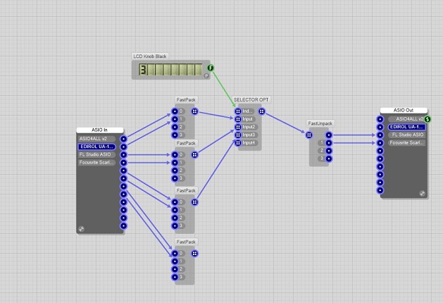

This has an audio selector menu, for internal sound driver selection- in the gui. the dial selects which STEREO PAIR of inputs get routed to the output. You could configure it to select through mono inputs as well, or any wild config for that matter.
Hope this helps, please share your results so we can all learn.
Audio Selector.fsm- (43.12 KiB) Downloaded 856 times
