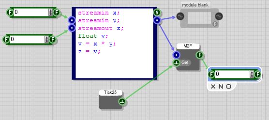

-When turning streams into green with mono2float, or poly to float array, or graph prims... it is real time, BUT the float is generated by samples taken at an instant == tick (tick25,tick100,custom), thus is open to inaccurate timing, and missing signal parts... as stream is running at sample rate (it is basically assembly language in clothing), and tick is (insert cpu clock jargon???)...
-you can reliably run green into streams, and the stream will = green, but not vice verse, and anything in green tangles will be open to these timing/accuracy issues...

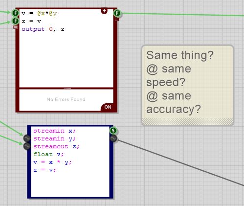

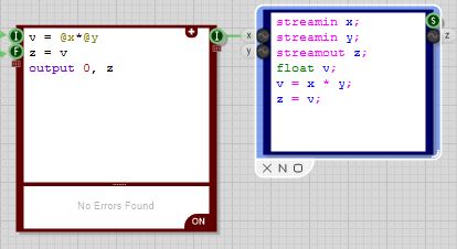

BUT is this the case with the ruby input/output? If ruby is processing at sample rate like a stream is, at the same level(buffer) as a stream, is the output to be trusted? Like if I process an INT array in ruby at sample rate, and output an INT... is that INT accurate, or is even that in/output hole subject to green inaccuracy? Can I run out of that ruby INT output directly into a stream?
(picture below)
If I do, is it at sample rate speed accuracy? essentially creating an uninterrupted stream from inside the ruby module processes, out of the INT out, directly into a STREAM in on a DSPCODE box, and out the other side? Is that whole chain sample accurate? or is that one step of green ruining it?

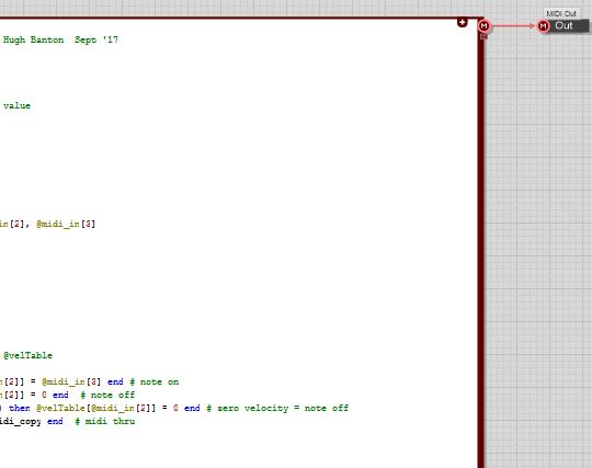

-If I send a midi event into Ruby, use ruby to dissect it into it's constituent parts, and output them as INT/string, are
-those INTs/strings as instantaneous as midi>voices>poly? is it faster? is it as accurate?
-Is midi > ruby >green out realtime/sample rate?

EDIT: Adding pictures
ruby directly to stream>>
111 4.JPG (24.17 KiB) Viewed 11280 times
