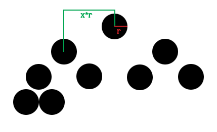

And here's a rough sketch of what I'm trying to do:
Green is just an example. I need it for every first circle per row. Now, the only constant in this is that the last row will always have the circles directly aligning. For that graphic x is 4 for row 1, 6 for row 3 and 7 for row 4. I've listed x for trees up to 8 layers now, and there is this break between 4 and 5

Are you sure that you're not mixing up r and d (= 2r)?
Re: A series of numbers: Help needed
if i understand your sketch correctly
row 5 should read: 0,8,12,14,15
row 6 should read: 0,16,24,28,30,31
which would be easy to solve...?
