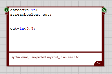

God, you are fast enough :) What should I need to do with that code? Insert on a ruby script?
Seems an error, but maybe I totally misunderstand. I'm a novice :lol:

Postby KG_is_back » Thu Apr 16, 2015 3:33 pm
Use DSP code component

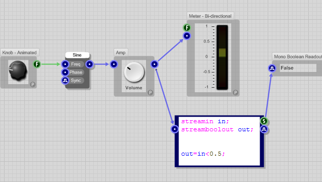

Postby Nowhk » Thu Apr 16, 2015 4:03 pm
Ok. Now I got this situation for testing this:
Not sure I'm doing it right :) I don't see any Green :geek:
What do you mean with "modify the mono boolean readout module"?
Nowhk

Postby KG_is_back » Thu Apr 16, 2015 9:12 pm
Double click the mono boolean module. Inside you will see how streams are converted to boolean. Add one output prim and connect it there.

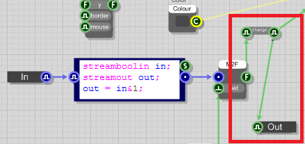

Postby Nowhk » Fri Apr 17, 2015 8:29 am
KG_is_back wrote:Double click the mono boolean module. Inside you will see how streams are converted to boolean. Add one output prim and connect it there.
In this way?
I see the Boolean in the output of Mono Boolean module, but it doesn't works: it doesn't trigger any bool with your method.
