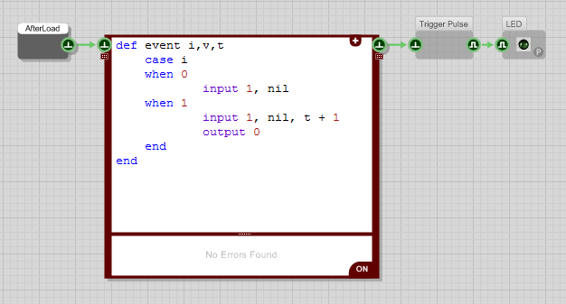

Simplest possible Ruby ticker below.
Thanks trog and tulamide!
