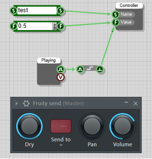

No. My plug output to the daw and stop. If I stop it and I edit the knob, when I restart it must re align the knob at state 0 value. But if the float has already that value, it doesnt refresh. Do you see?

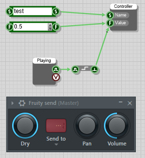

Re: How to retrigger a float (out) with same value?
Tronic wrote:
No man, it doesn't refresh
Here an example. My plug linked to the Volume knob of Fruity send.
If I manually write 0.5 (from 0, so different value) and I click enter on the Float module, I get the movement of the knob to the middle:
Now, if I manually move the fruity knob (with mouse) to another value (0.7 for example), and I play my DAW, it doesn't retrigger 0.5 to the knob (neither using your method above with trigger):
The knob keep to 0.7.
That's because the float module has not changed.
If I manually wrote 0.50001, it send again "0.5" (even if its not exactly 0.5, but 0.50001).
i.e. I'm still not able to retrigger the "same value", even using your method
- Nowhk
I don't have that controller prim, it seems to be FL Studio specific.
The circuit from Tronic is correct, so the issue could be either the controller prim, or the recognizing of the DAW playing.
Create a boolean. Connect the boolean output of the "Is playing" prim with the boolean. Everytime you stop and then start again, the boolean should switch to false and then back to true. Is it so?
If the answer is yes, the issue is related to the controller prim. You said it is reacting to a change when you do it manually.
Create a second float, set it to 0.5, but don't connect it to the controller prim. Stop your DAW. Now remove the links to the controller's value input and connect the second float to it. Does "fruity send" switch back to 0.5?
If not, then it is an issue with the controller prim, that we can't help with. You should report it as a bug then.
If yes, it might just be a timing issue and the trigger might just be delayed to work. But first check all the above.
tulamide wrote:Create a boolean. Connect the boolean output of the "Is playing" prim with the boolean. Everytime you stop and then start again, the boolean should switch to false and then back to true. Is it so?
Yes it is.
tulamide wrote:Create a second float, set it to 0.5, but don't connect it to the controller prim. Stop your DAW. Now remove the links to the controller's value input and connect the second float to it. Does "fruity send" switch back to 0.5?
No it doesnt.
tulamide wrote:You should report it as a bug then.
Ok so its the Controller prim the problem. Where do I report it as bug?
