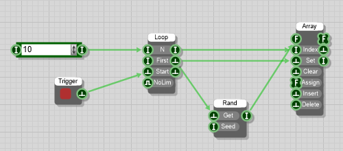

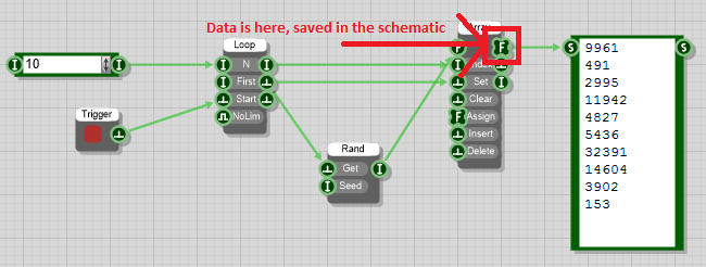

I mean: if I've somethings like this:
every time I open the schematic and I link the final [F] to a text module, I always see the same generated values (when I create them, clicking on Trigger linked to the Loop module). i.e. the result is always the same. This means that the data is "stored" to the last connector [F] inside the schematic:
That's fine! Got it. But...
Once I export this schematic to VST from FlowStone, and I open it, I can see the same data (so, it is saved to the plugin as well). The problem is when I change those data inside the VST: they change "live", but when I save the preset and I reopen it, I can see the old data (the ones when I create the VST), not the new ones.
I know I need Preset Manager and use somethigs like Preset String to restore data inside VST, but why starting from schematic it stores data and inside VST I'm not able? Is it correct? I guess it use the same variables addresses inside the code. So once changed, it should save them as well.

My understanding is this:
Arrays are like ROMs and you can only write to the ROM in Flowstone.
The array contents will be stored in the scehmatic but you can copy and paste an array Prim and it will still hold the data in its copied location.
You don't need a preset manager to read from the arrays in an exported VSTi.
The DAW should take care of saving the VST state when you save the project file in the DAW, providing every control has a unique name, otherwise confusion.

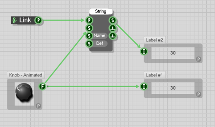

Re: A bit confused on how FlowStone store/load data
To make the explanation concise: this is how (in my opinion) thinkgs works.
Let say this is my plugin (that use Presets and Preset String prim) and I export it as VST:
when I now load it inside my DAW (init stage), it will load plugin variables and set for Label #1 and Label #2 the value 30. Since there is not any associated preset parameter value (no preset file source with data; I've not create it yet) the loading ends. I also think that here plugin will in any case create the list of preset parameters in memory, setting the current values; because if I look at the DAW preset list, I can see them with current value).
Now I move the knob to value 60, and I'll see both label updates. In this moment (I'm not on init stage anymore; but in event stage), plugin will also update VST parameter list (exhibit by the Preset Manager module; the single string in this case) to 60.
Than, I save the preset (thanks to DAW proprietary file, for example) and I reload it.
Now FlowStone first load (init) the plugin variables to 30 (so both Label #1 and Label #2 to 30 as before; of course, since I'm at init stage, it won't propagate data to VST parameter list from Preset String module), than invoke VST parameter list to refresh/reflect its value to the plugin (because this time there is a concise list of parameter with a specified value, not as before), and Label #2 become 60 (while Label #1 stay to 30).
Is it more clear? And most important: it this correct more or less?
