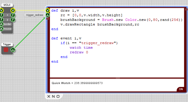

Hi all guys! I hope you can help me again ;)
I don't understand why I'm not able to call a redrawing of my View clicking on the Trigger button:
this should be pretty easy. Every Trigger click, a new Background color (notice the rand() function). But instead, only time in the "watch" zone change.

It does redraw the view. You just need to go to the toplevel to see it. It's better if you have the trigger button one layer higher, so you can observe it better, like here:

I see. Thanks! My problem seems that I can't "prevent" redraw:
