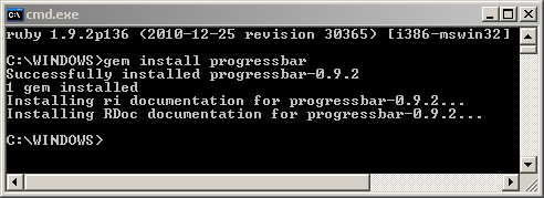

Step 3) download Install Gem on your system:
Put the downloaded gem in the gem folder: D:\Ruby192MSwin\lib\ruby\gems\1.9.1\gems (using your own path)
then in Ruby:
gem install gemname
You should see the gem install:
Gem Install.png (5.55 KiB) Viewed 40660 times

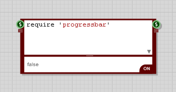

Step 4) Test Gem
Start with a new Ruby Edit module and test if it loads:
ie. require 'MyGemName'
Results: the first time it load you get a result of True, from then on False - both are good it has been loaded!
Ruby Gem Test clip-2.png (5.39 KiB) Viewed 40660 times
If the loaded gem causes a crash then it is the gem that doesn't work on Windows NOT FlowStone!
