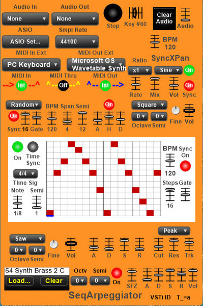

Another 'variation' of the two popular arp/sequencer mods ...
SeqArpeggiator can be downloaded as a ZIP File from the following link:
https://www.inventorefx.com/_ifxfstone/seqarp.zip
View Large Image:
https://www.inventorefx.com/_ifxfstone/seqarpefx_lg.jpg
Includes SFZ Sampler (Bottom of Module - Requires Soundfont)

Your sequencer clock is done in ruby so you may need a streamed clock if you want to sync it to your DAW. Here you have a good start:

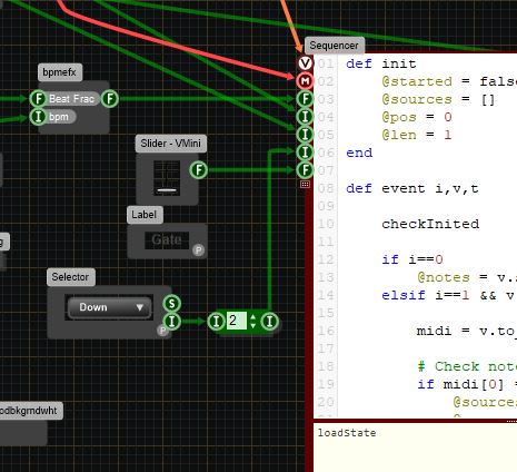

hi, thank you very much for this scheme, there is just something very important that I have not managed to get working,
It is the modality of the ascending, descending, combined and random sequence,
I think something is missing in the code, how to fix it?
I attach other scheme elaborated for me FSv3.0.6 schematic that also works for FS4 alpha
If they can write in Ruby the solution I elaborated,
to enable sequence modes
I would appreciate it very much.
