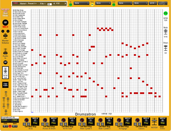

GRAPH GRID ORIENTATION
The Drum kit Graph Grid has the 'midimap' listing for each percussion instrument on the left side.
NOTE:
Drum kit Percussion Instruments are identified by their respective midimap
(*number) = piano keyboard musical note.
This tuning is based upon the GM (general midimap) reference.
Starting from the bottom and progressing upwards the Drum kit Graph Grid is 'tuned' from
(*27) = Eb0 to (*88) = E5
The description for each individual percussion instrument on the left is based upon this.
Drum kit MUSICAL NOTE TUNING
Different drumkit sfzs can vary in tuning for their individual instruments.
This will show non-matching instrument name/tuning on the graph.
Refer to the midimap reference for each different drumkit sfz for assistance.
DRUMKIT SFZ MIDDLE C CAN VARY FROM C3 TO C5 OR EVEN AN ARBITRARY PIANO KEYBOARD NOTE.
USE THE SAMPLER OCT/SEMI (OCTAVE/SEMIITONE) 'DETUNER' TO COMPENSATE.

I finally got to have a quick look at this.
VERY clever stuff inside!
But I was puzzled that when I put entries on the bottom lane I didn’t hear a Bass drum. I did load the sfz and I think I followed the instructions, but keep in mind I’ve only tried it in FS so far.
What am I not getting?
Re: Drumzatron SFZ Sequencer
The names on the left don't match up with the sounds being played except (maybe) after the initial load, when it's using the sample arrays that were saved with the FSM. Not to mention that which sounds you hear change depending on which key you use to start/stop the sequencer. It's almost like the start/stop key is transposing the preset sequence up or down.Spogg wrote:But I was puzzled that when I put entries on the bottom lane I didn’t hear a Bass drum. I did load the sfz and I think I followed the instructions, but keep in mind I’ve only tried it in FS so far.
And yes, that's using it inside FS, since I can't read anything in the GUI at the default standalone zoom level.
Here is the custom midi drum map used …
88 E5 Big Gong

If you're talking about the zoom control inside FS, I did that. My point is that the standalone version is unreadable on anything remotely resembling a high-resolution display.pwesynthmaker wrote:Use the zoom level to enlarge for better visibility.
- deraudrl
- Posts: 239
- Location: SoCal
Just increased the vertical graph size ...
https://www.inventorefx.com/
Inventor eFX Technology
pwesynthmaker - Posts: 82
...which enlarged the drum sound names on the left, but nothing else. Fine, I'll deal with that.pwesynthmaker wrote:Just increased the vertical graph size ... should work for 20/20 ...
Moving on, I'm still unclear on how the drum sounds map onto the piano roll. It looks like each row of the roll should correspond to the name on the left at zero transposition. That's certainly not what I'm hearing.
Also it's not obvious what starting with a different key besides middle-C does to that mapping, besides further confusing the already tenuous relationship between sequencer rows and drum sounds. (Actually, I have no idea what function the keyboard performs in the first place: given that there's a piano-roll sequencer and transposition controls, it's redundant and could be replaced with play/pause/stop buttons.)
