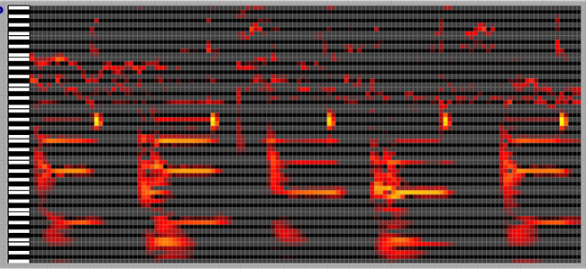

Hi gang,
this is a demo of a semitone spectrogram. It covers 4 octaves, I was happy to see that Ruby can draw 64x48 rectangles fast enough for a sense of motion. However, I am sure it can be done more efficiently.
The DSP part includes a filter bank of 48 4th order bandpass filters followed by envelope followers. There is still some headroom regarding expansions to more octaves as well as further optimizations.
Have fun!
Have fun!

Absolutely fantastic Martin.
Plus, this is just what I needed right now to analyse some samples for pitch for my ongoing Q-50 project

I rigged this up to find the base pitch of samples and to test with a simple tone.
I've tried quite a few samples and it's SO good (your module!).
This is such a great gift for me so thank you again

Finally had the time to test your Spectogram (I am so used to the word Sonograph, but it seems that word is nowadays used for those body scanners only?). Martin, that is fantastic. As always I have no clue how you realized that, but it is so impressive. I fed it with a stem file from one of my songs. It was a pad played with two notes, not changing. Your module identified the two notes without any problem. I might be wrong, but it seems that it also shows the strengths of the two notes (I played the higher note quieter than the lower one and the spectogram shows more color for the lower note), but maybe that's just a coincidence.

Updated the first post. Version 2 features 5 octaves and some other enhancements. Uses heterodyning instead of bandpass filters. Comments and suggestions, please.
