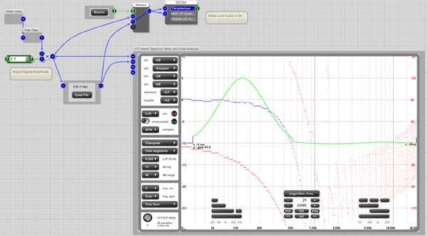

This is an upgrade featuring the Analyzer.
The .zip file contains three files.
You need to load one such file upon running the .fsm. This defines the FIR filter. There is a "Load File" button for that.
FIR_99 with coeffs from a text file (Analyzer) (600).png (92.58 KiB) Viewed 20565 times

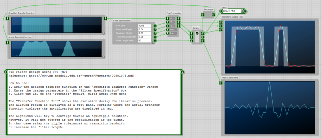

Postby martinvicanek » Sun Jul 21, 2013 6:20 pm
MyCo wrote:I've added the FIR coeff generator from Martin (from the Stream FFT project) to the FIR that I posted earlier... works quite well...
Cool. 8-)
This reference was mentioned in a recent discussion over at KVR regarding FIR Filter design. Below is an implementation in FS, it is quite easy to use and fun to play with. So far it only generates filter coefficients and shows transfer functions, I haven't plugged it into an actual FIR filter yet. Comments appreciated.
FIR_Iteration.fsm
(126.69 KiB) Downloaded 1820 times
