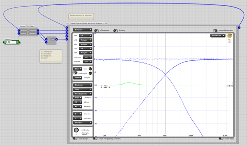

With lambda = 0.52 the filter got warped for Fc becoming 1 kHz instead of 3 kHz when not warped.
The blue curves are : lowpass, highpass, sum.
The lowpass magnitude looks good. One can say that the 3rd-order slope is still there, however the transition band looking a little bit soft. Remember, there are only 31-taps.
The highpass magnitude look perfect. The 3rd-order slope is perfectly there.
The sum magnitude looks perfect. All frequencies are there, at 0 dB.
The green curve is the impulse response of the selected output. This is where it gets tricky.
The lowpass impulse response looks encouraging. The impulse response shows almost no preshoot and no ringing.
Worth noting is the apparent group delay, about 1 millisecond.
Remember this is a lowpass filter. The high frequencies don't appear here.
Unfortunately, the highpass impulse response looks tortured. Clearly the highpass phase gets distorted.
The highest frequencies exhibit no group delay (they come first), while the lowest frequencies exhibit the 1 millisecond group delay seen in the lowpass. That's quite a smear in time domain. This is caused by the delay cells transforming into phase shifters when lambda not equal to zero.
Unfortunately, the sum impulse response looks tortured. Clearly the global phase gets distorted.
A plain conventional 4th-order Linkwitz-Riley built using IIR Biquad filters exhibits less phase distortion. Why is that so ? In the 32-tap warped-FIR filter, we have 32 phase shifters in place, causing a 32nd-order phase distortion. In the 4th-order Linkwitz-Riley, we have two IIR Biquads in place, causing a 4th-order phase distortion. Which is a lot less.
Thus, as soon as we apply a warp factor (lambda not equal to zero), we get a 32nd-order phase distortion. Now comes the question of adding a phase corrector. Say the phase corrector requires a 32nd-order IIR filter, built using a lattice or using Biquads. This would double or triple the total computing cost, just like we used a plain simple 64-tap or 96-tap FIR. Is it worth doing this? Probably not, as a 96-tap plain simple non-warped FIR programmed for Fc = 1 kHz provides an excellent 3rd-order lowpass, an excellent 3rd-order highpass, and a perfectly linear phase.
Now consider warping from Fc = 3 kHz to Fc = 300 Hz. This is a factor 10. Roughly, a non-warped FIR delivering the same precision (in frequency domain) as the warped-FIR, would now require 320 taps. On the other hand, the phase distortion could remain 32nd-order, isn't? If this is true, the same phase corrector as above could be tuned for restoring a good phase linearity. The total computing cost would thus remain approx same as a 64-tap or 96-tap FIR, this time emulating a 320-tap FIR. This is worth looking further, IMO.
But wait a moment. If we manage to correct a 32nd-order phase distortion, why not using the same expertise for correcting the 4nd-order phase distortion produced by the 4th-order Linkwitz-Riley? This is a strong argument, possibly final argument, against warped-FIR filters.
