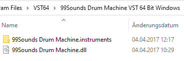

Exposing the complete file system is potentially dangerous. I won't do that. People should organize their plugins, in that they put it in a folder, with everything needed externally along with it. Like in this example:
The root folder would then be "99Sounds Drum Machine.instruments". Imagine, you'd enter "C:\" as root folder! My system does a complete recursive file search everytime you click. I can't even imagine how long it would take to search through some 300,000 files in 200,000 folders to build the tree-list of your complete harddisk (let alone building the popup menu)!
