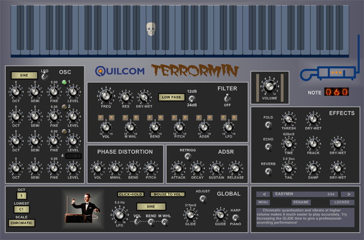

Yep, spog already did it for us nicely (although that skull is not my personal taste and I switched it to spiderman!
Just one more question: Can that mouse note module you've created become vertical instead of horizontal? I mean like the piano rolls of DAWs? We still don't have such a keyboard on the forum. It can be very useful for some.

Just to say that I’m currently adapting the Mouse Play to what I think is required, using trog’s wonderful tool to mediate the MIDI side. I mention this now to maybe avoid duplication of effort.
It’s going really well and already working.
More to do of course.
Initially it’ll be the same horizontal format as the Terrormin and work the same way. Once that’s done I’ll post it and then work on a vertical version, but I’m worried about the keyboard display which is all Ruby.
Re: The Quilcom TERRORMIN: Music with your mouse!
^ Great news, Spogg, I'm looking forward to it. In the mean-time, I'll have a little poke around in the keyboard Ruby code to get an idea what kind of surgery might be required - swapping the axes doesn't usually involve too much messing around.
