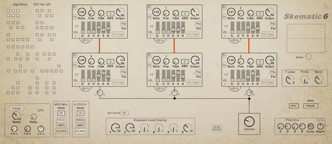

Here's the six-op, multi-algo version I mentioned a few posts back, not a DX7 emu; more like a six-op expansion of the DX27/100, with 14 algorithms. Clicking on the simplified graphic representations on the left selects algorithm (lines between operators change to show algo connections); the DX7 equivalents are displayed at top. Each Carrier has a pan control. Unlike the DX instruments , any combination of operators can have feedback (even Carriers). Operators can choose from four different waveforms. Envelopes can toggle between AHDSR and DADSR.
Skematic6
SkematicGS and SkematicGSx have been updated in their initial posts - improvements to the Amplitude Modulation controls.

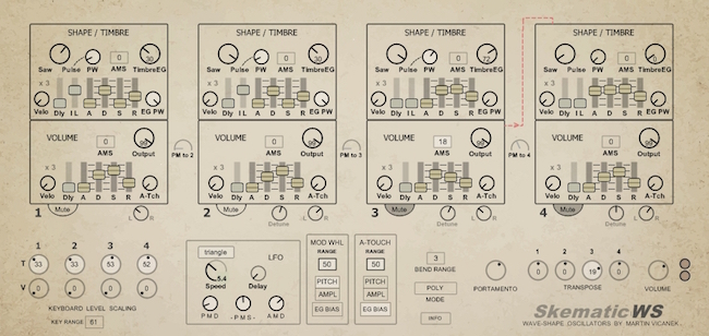

Here are all the Skematic... synths in a single Zip -
including a new one - SkematicWS :
which is similar to SkematicSP (which uses Martin's Spread Partials osc), but uses the Spread Partials' predecessor, Martin's WaveShape osc, which seamlessly morphs sine to a saw-like shape. SkematicWS has two of these per 'osc' so can produce pulse waves also and has a Saw/Pulse crossfader. Though the SP osc can also produce this saw-like shape, it has no phase input, so can't do pulse and can't do 'FM' (phase modulation). With SkematicWS, osc 1 can FM 2, 2 can FM 3 and 3 can FM 4. Includes a few simple 'demo' style presets.
