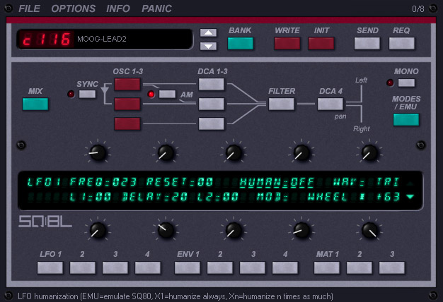

A fabulous-sounding plugin called SQ8L, which is an apparently very accurate emulation of the Ensoniq ESQ-1/SQ-80 is no longer being developed. Despite it's accurate emulation and great sound, I find it's interface to be slavishly imitative of the hardware and not very pleasant to use - with hard to read 'fake' LED numeric readouts and many sub-menus, etc.
I built a much friendlier ESQ-1-inspired plug that has all controls on a single page and easily visible, simplified envelopes, etc., but doesn't have the original instrument's numerous waveforms; just a random collection of wavetables that I gleaned form others' SM schematics and things I found on the old SM forum. It would be a great project to do a version of this with all the correct waveforms. The original instrument's wave ROMs are available on Rainer Buchty's ESQ-1 website, buchty.net. I e-mailed him about the possibility of converting these to numeric strings that could loaded into the wavetable oscillators, and I got a very detailed response that is I'm afraid mostly over my head (I don't know coding):

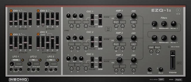

Here's my schematic (the more 'mature' version with standard 'analog' style oscillators):
Insoniq EZQ-1a.osm
(1.14 MiB) Downloaded 1352 times
Insoniq EZQ-1a copy.jpg (34.85 KiB) Viewed 28452 times

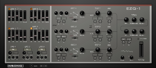

Here's the original version I did with the wavetable oscillators, though it hasn't yet been updated with a few refinements I made to EZQ-1a:
Insoniq EZQ-1.osm
(519.02 KiB) Downloaded 1375 times
Insoniq EZQ-1 copy.jpg (90.87 KiB) Viewed 28452 times
