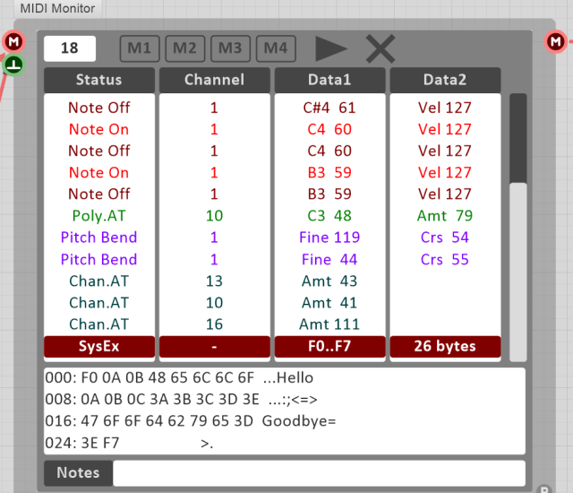

Hi All,
In the process of getting started in my latest project, I had need of a few tools to help me with debugging a lot of MIDI processing. I thought I'd share a few here that folks might find handy. Inside each module is a comment containing instruction for how to use it. Only the MIDI monitor has a module GUI; the others only have properties pages (locked open as saved.)

SysEx Builder

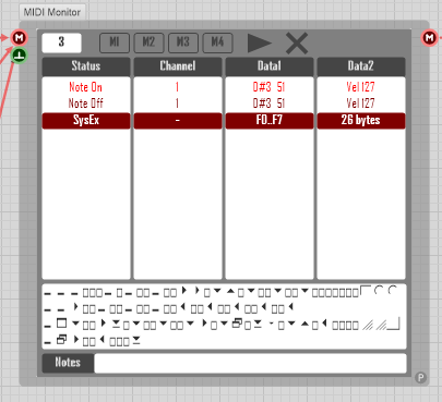

=> Ooops: "Double L-click a SysEx message to show a complete dump." only shows blank - tested with sysex in FS 3.06
also "Double L-click a regular 3-byte message in the main display to open a text box showing its bytes in hex." shows nothing here...

Walter Sommerfield wrote:=> Ooops: "Double L-click a SysEx message to show a complete dump." only shows blank - tested with sysex in FS 3.06
Hmm, that's strange. I can't reproduce that here at all (I tried from the link above to make sure that the download isn't corrupted.) I'm also using 3.0.6, though the schematic has been tinkered with in later versions, and I might have some 3.0.8 files in my install paths somewhere. If I get time, I'll do a proper clean install, just to make sure.

I've just had a thought what might be the problem with the invisible SysEx dumps in the MIDI Monitor. The hex display uses a different font than the one selected for the main window, because it needs to be a fixed width font. I may have chosen something which not everyone has installed.
I've uploaded a new version to the top-post which has properties added for the hex view font and font size. Even if it doesn't fix the problem, they really ought to have been there anyway!

Re: MIDI Debugging Helpers
Well - i thougth about wrong font too...
But had less time to look into ur schematic further.
Now we are closer - see pic...
Changed Marlett font to my now favorite Calibri - et voila: works fine
Thanks again for this!
