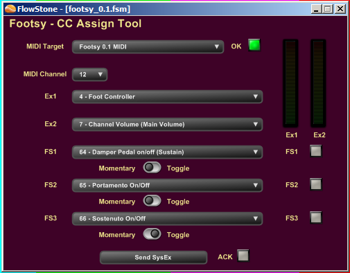

Here's a very simple project I built to control a Teensy-based MIDI controller with a few bytes of system exclusive messaging. (The controller is just a box with a Teensy and some 1/4" sockets for up to three foot-switches and two expression pedals - since it's Teensy-based I'm calling it 'Footsy'.)
The message instructs the controller which MIDI channel and which CC numbers to communicate through.
The message consists of the start and end sysEx bytes, a four-byte Key and 9 bytes of program data.
Selectors generate the main 'message' part of the sysEx string (9 hex bytes)
1 - F0
2 - 7D
3-6 - Key
7 - MIDI channel (1-16)
8 - Ex1 CC
9 - Ex2 CC
10 - FS1 CC
11 - FS1 0=momentary / 1=Toggle
12 - FS2 CC
13 -FS2 0=momentary / 1=Toggle
14 - FS3 CC
15 - FS3 0=momentary / 1=Toggle
The code in the controller sends back a three-byte ACKnowledge message "F07DF7" which displays on the panel.
The indicators on the right-hand side let you see the controls are working as expected.
While the project is very simple I'm posting here as I think there might be some interest in FlowStone from Teensy builders -- many of whom appear to be involved with MIDI projects (Teensy allows MIDI communications over USB directly... unlike Arduino and its clones). FlowStones other features like easy access to the COM port may also be of interest.
EDIT -- corrected EX displays which were in the wrong positions on the front panel for first 7 downloads
I don't image anyone who downloaded was building the thing... but just in case.

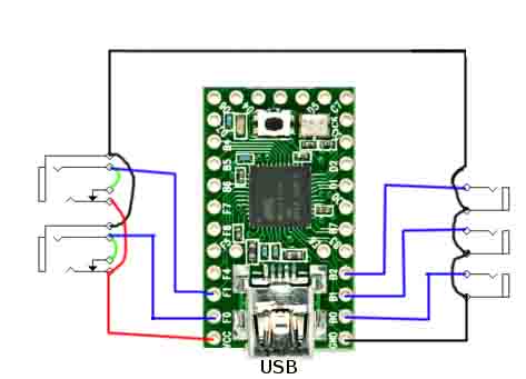

Here's all that's inside the box:
Unfortunately I couldn't find a TRS that had a switch on the Ring connector at my local electronics store so this pulls the analog pin on any unused EX pedal socket to VCC instead of ground but the device-code will only send a CC=127 msg if you're connected when you unplug. [EDIT - this is needed to prevent the pin's voltage from 'floating' and generating garbage messages. You have to pull it to one side or the other when not in use.]
So... apart from getting some Teensy people to consider FlowStone I hope this might get some of you to try Teensy.
They're not expensive (if bought directly from Paul's site) and they're really easy to get started on -- especially for MIDI where you can just plug directly thru USB without the software kludges standard Arduinos seem to require.

Re: SysEx generator for Teensy-based MIDI controller project
Hi oddson again,
that's even more awesome
I want it to act like a switch to the 'outside' not like urs as an input... think i need a relay 4 this
I worked in a QC Team in a manufactory with SMD pick-and-place machines etc. before now as a freelancer but i'm now a little rusty
Thanks 4 showing even the innermost part of ur box!
maybe we can collaborate a little in my project... tried the FT232 - then thought about HID but had other projects in my head...
Now FS features HID but cannot produce core friendly exes
