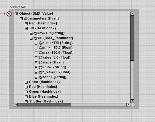

Well i was looking for am Methode how to view different data of ruby objects. I think the inspect funtion is nice - but i thin you will like that more:
The structure of such data-trees might be known by everyone of us - so i just thought of how about embedding it
Limmits:
I had no idea how to Display Hashes better - so i made a subclass for each hash index to get the object of the index and the object of the value
You could go as deep as you want ^^
For a better look i did place you one of my DMX-Objects inside - Please no not use those classes - the code was also deleted so it might give you no usage - but you are alowed to learn from it XD
This is an early BETA maybe some rubyfreaks have better ideas here
EDIT:
Update to BETA 2 / 3
Fixes scrollissue
Update to BETA 4
New Classnames for scrollbars/areas
Regards

Fantastic work, Chackl; a great example of the kind of de-bugging tools that I have always wanted in FS.
