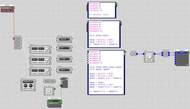

You can use it for pretty much everything, that's so great about it. In case you want to give it a try for whatever you're thinking of, here's a dsp version of all three interpolation methods (linear, quadratic and cubic).
Just remember, whatever you feed it with, it interpolates from a (t-value = 0) to d (t-value = 1), over b and c. So t-value = 0.5 means, all 4 inputs are present with all the same shares.
Would love to see something made from it :)
