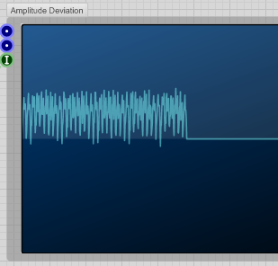

@MyCo: Indeed, a recursive oscillator is a filter driven to self-oscillation. With regard to drift, you can analyze those beasts theoretically and classify them as unstable or hyperstable, respectively. The unstable ones don't have their poles exactly on the unit circle in the z-plane, hence the amplitude runs away exponentially. That may start out very slow in the beginning, but ultimately the thing will blow up or collapse. The only way to tame these is to apply some gain control mechanism. The coupled form is one example for this class. The hyperstable ones, on the other hand, do have their poles exactly on the unit circle, hence there is no systematic runaway but only a possible drift due to roundoff errors in the iteration. That difference may seem subtle, but it is not. The oscillators in my schematic are hyperstable.
Yes, I did some testing and let them run freely for half an hour or so. The amplitude remained constant (deviation was less than 1e-4). However, I want to have a closer look, run longer periods and also record some statistics. Thanks for asking.

Okay, so I did some more testing regarding drift of those freely running recursive oscillators, with some interesting results. Below is a log from an overnight run. The display shows the amplitude deviation from unity magnified by 1e+4, taking 1 sample each minute. The amplitude fluctuations are confined to a band of possible values, there is no growth or exponential runaway. I would have expected a random-walk-like deviation proportional to the square root of running time, however the oscillator seems to get trapped in a limit cycle instead. I found this behavior in all test cases in a wide range of initial conditions and input parameters. So this is good news.

martinvicanek wrote:The amplitude fluctuations are confined to a band of possible values, there is no growth or exponential runaway. I would have expected a random-walk-like deviation proportional to the square root of running time, however the oscillator seems to get trapped in a limit cycle instead. I found this behavior in all test cases in a wide range of initial conditions and input parameters. So this is good news.
This is good news indeed. And quite surprising too.
